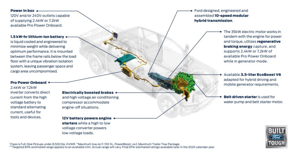

we got our truck last week after 1.5 months in the shop (just as long as we actually got to use it) - the last 'fix' to replace the entire wiring harness that connects to the hybrid battery / power system (i'm guessing it goes back to onboard power and up to hybrid transaxle given the shop had to remove the exhaust to get to portions of it) has solved the issue and seems to have improved the hybrid functionality a bit, staying in electric mode for longer.
Really happy to have to truck back but with the continued findings of poor factory quality control (the most recent circlip driveshaft recall) I'm still telling everyone to hold off for a year or two.
Overall I wouldn't trade the hybrid though, it's fantastic to have a truck in the city getting what a gasoline 4 cylinder sedan would MPG wise!
Image is from https://www.motorbiscuit.com/wp-con...-F-150-hybrid-powertrain-diagram-1024x544.jpg
Ford F-150 2021 hybrid transmission problems? 2021-Ford-F-150-hybrid-powertrain-diagram-1024x544
